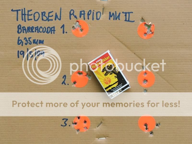

I have three cal. 25 guns: The Daystate AR80 ft/lbs, A Theoben Rapid MK II, and a custom Daystate Huntsman... The latter is the most accurate of the three, but unfortunately I dont have pictures. The Daysstate AirRanger 80 is a laugh. It spits out Barracudas at 320 m/s (1050 ft/sec) but you cannot hit a barn door at 100 mts (330 feet). In fact you would be lucky to hit the barn itself.....
The Barras dont seem to handle those speeds very well. That said, The DS AR80 has an unchoked rather unusual barrel and the barrel does not help much at all.
My Theoben Rapid with a LW match barrel delivers some 240/245 m/s (approx 800 ft/sec) and at that speed the Barras perform quite well in the Theoben.
Below are a couple of images.....
The first one is four 5 shot groups from the Theoben Rapid at 40 mts. Speaks for itself. Rather gusty conditions too.....
At 50 mts the groups (six shot groups) open up quite a bit, - but that may be just as much because I am a lousy shooter.......... :smex:
My conclusion is that Barras are at their best around 250 m/s. A conclusion I know many would agree to.........
But every rifle is different..........

Very nice rifles you have.... .... Yes you are right, seems every rifle wants to shoot the same pellets differently... those are nice groups... I have not tried Barracudas at the slower speeds so maybe I am missing out on some accuracy by trying to still shoot them too fast....
